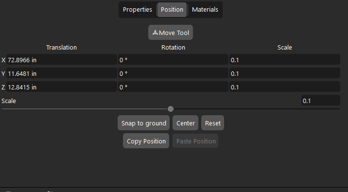

Which of these 3 tabs are selected when bouncing around the interface? 99% of the time I want it to land on the middle Position tab, and there doesn’t seem any way to make that happen?

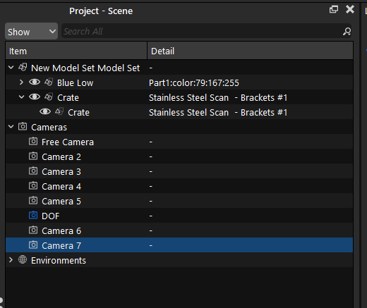

The default behavior in the Project Camera pane is a single click activation, is there a way to make that the same for the camera list in the Scene Tree Display? The objects in the scene tree only need a single click to activate (double to edit material which is AWESOME) so would be nice to match that behavior.

Scene Page Option Tabs The selected tab should, in general, be the previously selected tab. I think the problem you’re observing is that not all scene item types have the same tabs. This means that if you’ve selected Position when switching from a geometry (which has Properties, Position, and Materials) to a camera (which only has Properties and Materials), then the selected tab will change to Properties (because there is no Position tab). Then if you switch back to the geometry, the Properties tab will still be selected. Is this the behavior that’s frustrating? Would it be better if it remembered the tab per scene item type? I imagine that could cause some frustration as well, though.

Single Click Cameras I don’t think this is possible at the moment, I’m afraid. Again if its greatly needed, it’s of course something that can be discussed :).
